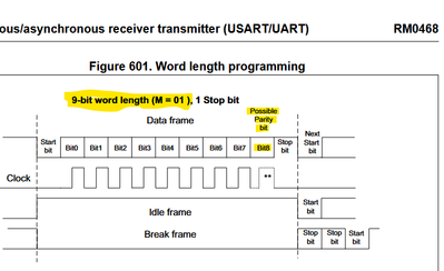

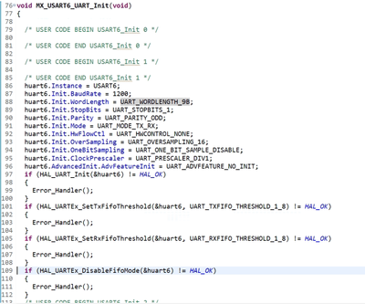

-> "1200 bps, 8 data bits, ODD parity, 1 stop" this is correct for HART.
However, ST includes the parity bit as part of the data frame, make sure the USART word length is 9:

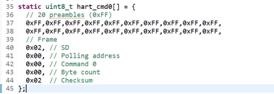

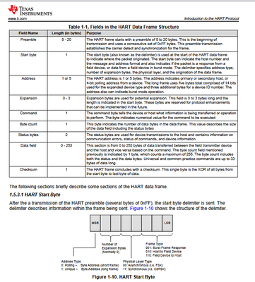

The 2088 transmitter is not going to respond unless you send a properly constructed HART message (Start byte after preambles, ending with checksum, etc.:

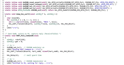

Hey,

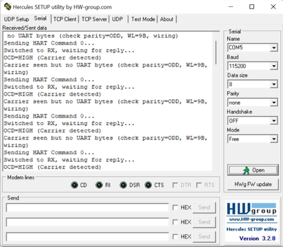

mentioned below is my Usart6 used to communicate with DS8500.
Now, i will show you the command i am sending.

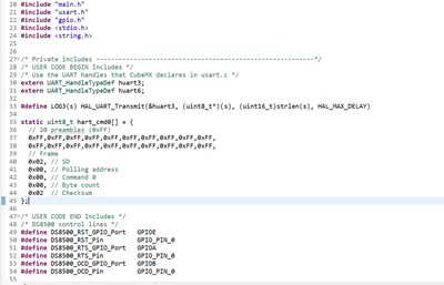

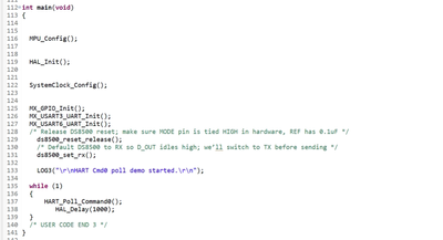

now let me show you my code
Faizan_001_2-1755641777074.pngFaizan_001_3-1755641813897.pngFaizan_001_4-1755641851291.pngFaizan_001_5-1755641891647.png
and this is what i am receiving on my serial monitor
Now what could possibly be the issue?
