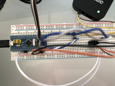

I have been trying to get a CAN bus going using the STM32 Blue Pill board with a TJA1050 CAN Transceiver, but for some reason even with basically copy pasted example code I don't even get activity on the lines. The transceiver modules I am using has the CAN bus terminating resistors built in resulting in a 60ohm resistance between the H and L lines. I've ended up putting together a basic test Tx and Rx bread board in hopes of figuring out whats going on with no clues. The Tx loop eventually goes dead for some reason which makes me think the HAL_addTx started locking up. Linked is a github repository with both projects. Also a video of the boards.

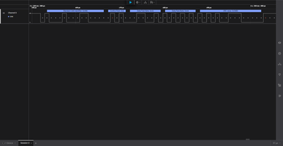

I tried your CAN Tx Test and it seems to be working fine:
I don't think I made any changes, but I attached the project to this message.  Note that I don't have anything connected to the STM32F103C8T6 except for the TJA1050.  I don't even have a 120 Ohm resistor.  I just have the output of the TJA1050 connected directly to the logic analyzer.  I would start there, remove everything and make sure the logic analyzer is showing the data being sent, at least then you know the data is being put out on the wire.

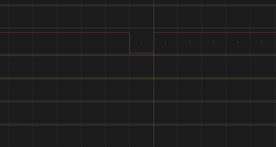

Using your zip with the same setup you mentioned, just the blue pill and tja1050 module. I even removed the onboard 120ohm for a test. I still get no activity on the can bus, however I do get this on the can tx line consistently. I am sure my logic analyzer works as I used it on the i2c of the oled display. Now I am worried my boards are not genuine but still passed the blue pill diagnostic thing. I have tested this on 2 different boards the second I have not run the test on. Where did you purchase yours? I am using PA12(Tx) PA11(Rx) 5v and ground.

I don't know how much it matters but are your wires twisted together for the CAN wires?  I have very loosely twisted wires from the TJA1050 to the logic analyzer, maybe it shows up in the photo.
Doesn't make sense why it works for me with the exact same setup.  Have you stepped into the code to see where it might be failing?
