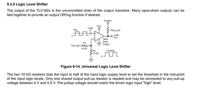

I'm designing a PCB that can get 8 digital inputs and 4 analog inputs. But these inputs can be range from 3.3v to 24v. For the digital inputs I have used universal logic shifter method using comparator where I can give any voltage range of digital inputs and I get 3.3v digital output for the stm32 controller. Likewise, is there any method to get analog inputs with that flexibility. I have tried op amp with attenuating method but each time I have to change the resistor values according to the voltage I'm giving. Is there a method to get analog inputs to stm32 ADC pin with the flexibility to use 0-24V voltage range analog inputs without changing any hardware like the digital input circuit?

For the digital inputs I have used universal logic shifter method using comparator[...]
First off all I would not use a simple comparator as a digital input. I would use a Schmitt trigger, which is a comparator with hysteresis. You can select a fixed threshold, but it might be better to give each comparator 2 selectable ranges. You can use mosfets to switch in different resistors in your circuit in software.
