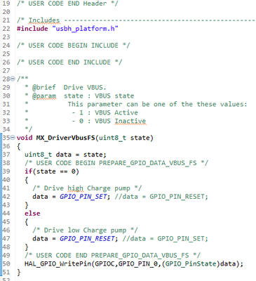

I downloaded the app from this site, and the project from 2020 works. However, even though I followed the same tutorial, my code doesn't work in the 2025 version.
spacemonochrome

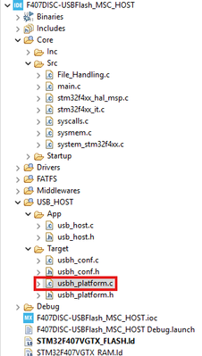

This solved. F407-DISC USB MSC Host 2020 old version usbh_platform.c
if GPIO_Output PC0 state = 1 > GPIO_PIN_Set
if GPIO_Output PC0 state = 0 > GPIO_PIN_Reset
but the 2025 new version its reversed
if GPIO_Output PC0 state = 0 > GPIO_PIN_Set
if GPIO_Output PC0 state = 1 > GPIO_PIN_Reset
I Chance usbh_platform.c and this problem solved
