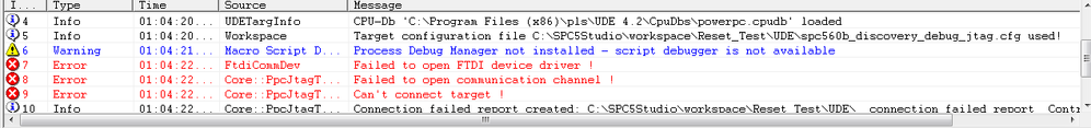

I am using UDE 4.2 version for flashing SPC560B54L5 board.
When I am trying to Flash the program I am getting the error '' Failed to open FTDI driver'' as shown in the below snapshot. I also tried installing board specific FTDI driver (Royalty free d2xx direct driver for FT2232 part number) which is also not working.
kindly support in resolving the issue or kindly share the FTDI driver need to be installed

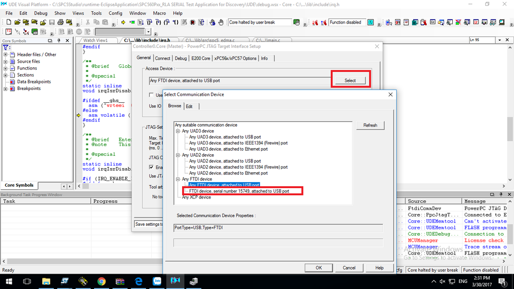

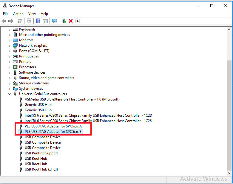

2017-03-30 12:37 AM
Hi, first you check driver in Device Manager for see installation is successful? And it is recommended to use version 4.8
If the driver is installed successfully, you try to check ''Config -> Target Interface...'' to see FTDI Device are display?
Wish you success
Best regards
Dong Tran Thien

2017-03-30 12:48 AM
Hello ,
if FTDI driver is not installed in your windows environment,
you can reinstall it,
the driver is located in this directory
c:\Program Files (x86)\pls\UDE Starterkit 4.8\JtagUsbDriver\
Best Regards
