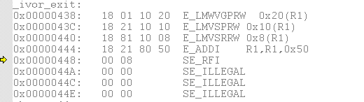

Hello everyone, I'm working with SPC56EL60L3.
I'm doing some functional testing, and sometimes my application gest stuck.
This morning I found it stuck once again, I took a look using the debugger and I found it was exceuting _ivor_exit (please see the picture below)
Looking at the startup code (ivor.s), I found the following code, which looks like the only piece of code related to ivor_exit.

Reading the documentation I found IVOR_10 is related to decrementer interrupt.
As far as I understand, decrementer can be used for implementing software timing.
OK, what if I don't need decrementer (and I don't want its interrupt to interfere with my application?).
One more thing:
I found the following sentence on the programmers manual:
''MSR[EE] also enables external input and decrementer interrupts.'' (RM004, page 272)
It looks like whenever I enable interrupts setting the EE flag in MSR register (I use irqIsrEnable(), for this), it also enables decrementer interrupts.
What If I don't want decrementer interruotys to be enabled?
Should I make any changes to irqIsrEnable()?
Thank you.
Regards
Alessandro

Hello Alessandro ,
you should put this compilation switch in FALSE
#if (IRQ_ENABLE_IRQ_PREEMPTION == TRUE)�?�?�?
if you want disable IVOR10 (Decrementer),
youhave not to enable DIE (Decrementer Interrupt enable) in TCR SPR 340
 asm (
 'e_lis %r3, 0x0040 \t
' /* DIE ARE bits. */
 'mtspr 340, %r3' /* TCR register. */
Best regards
