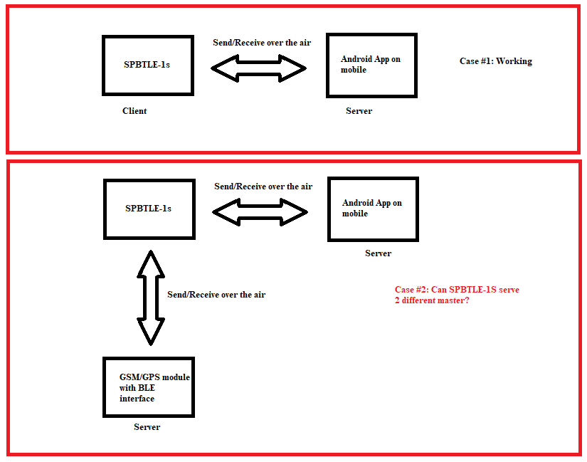

We developed a device using SPBTLE-1S that sends and receives data (like SPP) to an Android application (on a mobile phone), based on the BLE_Chat firmware example.
We would also like to include one more device on the above configuration, can the SPBTLE-1S serve a second connection on the same time?
I am attaching a picture to clear what i mean:

Hi SProg,
Yes, SPBTLE-1S (BlueNRG-1) can serve a second connection at the same time.
Sample project and scripts are available in DK 3.1.0 and BlueNRG GUI 3.1.0:
  • BlueNRG-1_2 DK 3.1.0\Project\BLE_Examples\BLE_MS_Formula\
  • C:\Program Files (x86)\STMicroelectronics\BlueNRG GUI 3.1.0\Application\scripts\Multiple_Connection
  • C:\Program Files (x86)\STMicroelectronics\BlueNRG GUI 3.1.0\Application\scripts\MultipleConnections_Formula
Please also reference documents:
C:\Program Files (x86)\STMicroelectronics\BlueNRG-1_2 DK 3.1.0\Docs\Multiple_Connection_Formula\Multiple_Connections_Formula.html
C:\Program Files (x86)\STMicroelectronics\BlueNRG-1_2 DK 3.1.0\Docs\Multiple_Connection_Guidelines\Multiple_Connection_Guidelines.html
DT0107 - Slot allocation and multiple connection timing strategy for BlueNRG, BlueNRG-MS, BlueNRG-1 and BlueNRG-2
https://www.st.com/resource/en/design_tip/dm00518102.pdf
PM0257 - BlueNRG-1, BlueNRG-2 BLE stack v2.x programming guidelines
https://www.st.com/resource/en/programming_manual/dm00294449.pdf
for chapter 3.9, 4
