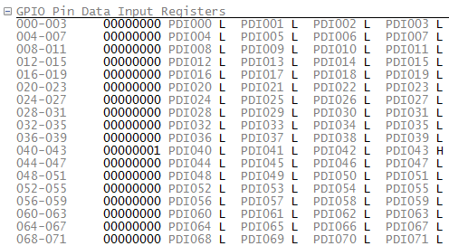

I have one square signal mapped on eTimer0 channel 0 on the C[11] pin alternate function.
I could see my signal shift from high state to low state with Trace 32. So I think my signal is correctly mapped to the input.

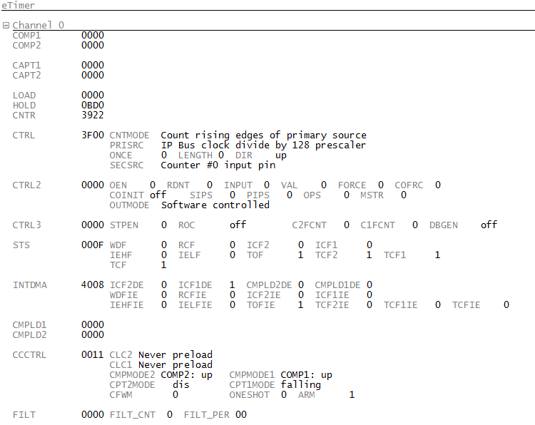

Here is my eTimer channel 0 configuration  :
I have a signal with a 12,5 kHz tick time and a 16 Mhz SYSCLOCK.
Unfortunately, there is no events on CAPT 1 register.
First, I was wondering for some time synchronization issues but when I select ''Count rising edges of primary source while secondary input high active'' CNTR just stop. So I suspect that the counter #0 input pin is not linked with my input signal. I could manually see values on CAPT 1 when I change SECSRC polarity with the SIPS register, but thats all.
Is there any mistakes with my eTimer configuration register ? I am also wondering how I could synchronize IP bus clock and my sensor signal tick time with just a 128 prescaler.

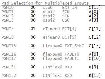

After 2 weeks of debugging, I figured out that ETC[N] pad are linked with 'Counter #N Input pin'.
So if you decide to use the 'ETC[4]' pin for eTimer0 input source, you have to choose 'Counter #4 Input pin' register.
I think you may clarify that in the table N°373 in the SPC560P34..40 reference manual.
I never saw any acronym definition for 'ETC[N]' (ETC = E Timer Counter [N] ?).

Hello Florent ,
Sorry for not helping you earlier.
yes , i am agreed with you Table 373 is not clear.
i have escalated your point in the Technical Writer team.
Do not hesitate to use the Pinmap Wizard in SPC5Studio
