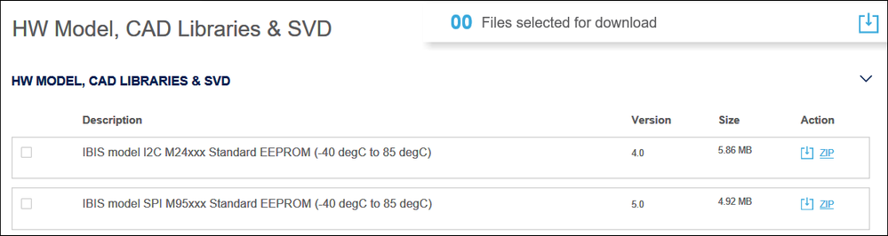

IBIS models (IBIS = Input/Output Buffer Information Specification) according to ANSI/EIA-656A. In fact, many of them have been published our website - on related product pages. see this example:

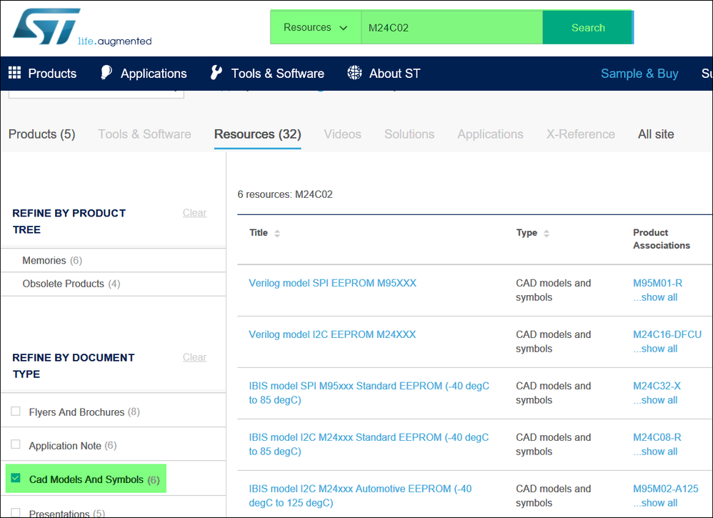

Proceed directly to product folder of selected ST part or use SEARCH with filter options like this:
