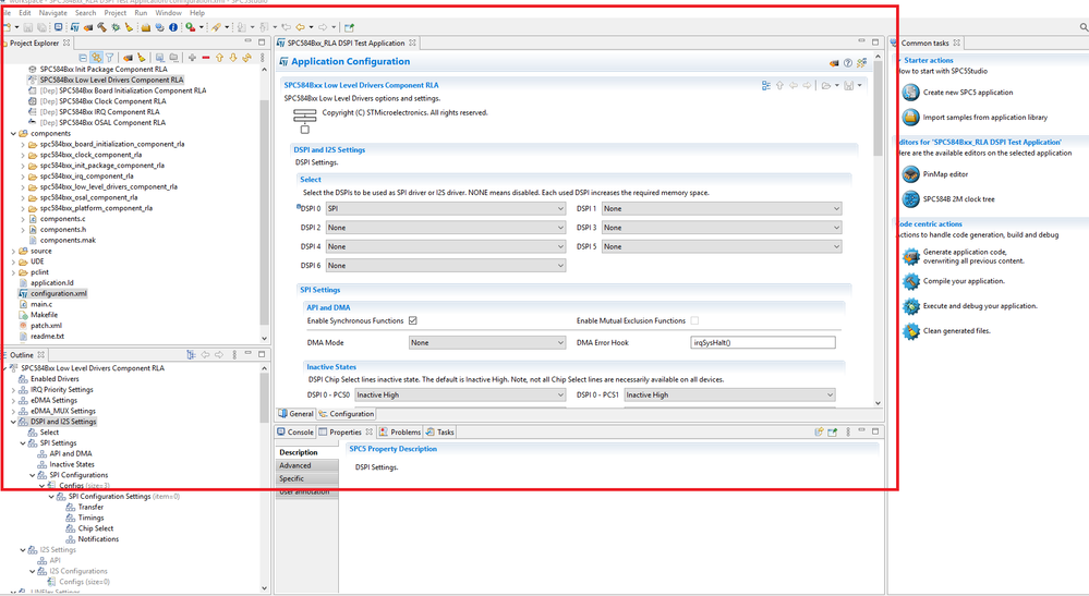

As you know we are working on the Custom BLDC Driver Board with SPC platform in that we are facing the Some issue in the FOC integration.
Current environment and setup:
1. FOC Source code (SPC_MCTK_LIB) for SPC560p DISP Board
2. FOC source code for X-Nucleo IHM001 Board.
3. SPC560p Discovery Board
4. X-Nucleo IHM001 Board with Bull running Motor.
We are trying to replace the L9907 driver Board from the SPC_MCTK_01 kit with L6230 driver Board of X-Nucleo IHM001 Board.
Queries
1. Current FOC code Part of SPC_MCTK_01 has the L9907 driver code, We are trying to replace the l9907 driver code with L6230 driver code to suite our custom BLDC motor drive. Please guide us which and what part of the software has to be changed in order to make this integration correct.

Hello Mari ,
Which IDE do you use for your work ?
For this work, I would use SPC5Studio 6.0.
Recreate api , internal , register from spc5xx_l9908_component_rla
Do you access to MCTK Features/plugins for SPC5Studio .
Best Regards
Erwan

Saravanan_Mari
We are using the Same as you suggest one only(SPC studio 6.0)
In that we doesn't have the Driver layer for the L6230 driver code
I dosen't know what are the MCTK Features/plugins for SPC5Studio.
Please explain this for us to understand this deeply and moving forward..
