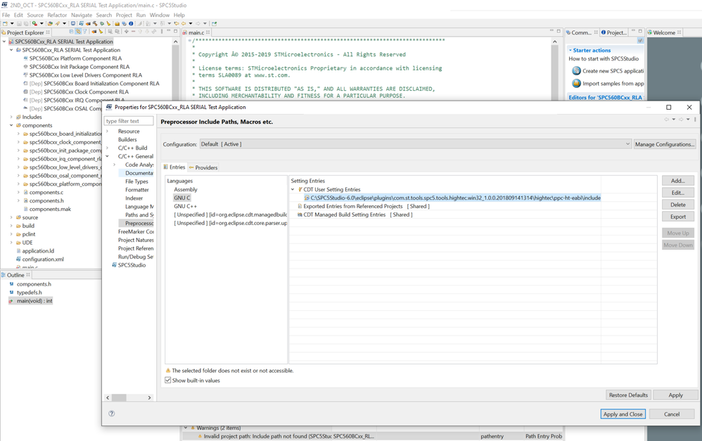

Hi All, Having error with typedef e.g. uint32_t could not be resolved. I have found from Q&A that adding these paths in C/C++ General -> Preprocessor, Inc. will fix (as shown in the attachment). Issue now: The selected folders/path doesnot exist or NA

Your CDT settings is not updated maybe after importing an old application.
directory does not exist anymore and preprocessing is failing.
you can update it by add a new directory which contains include files
c:\SPC5Studio-6.0\eclipse\plugins\com.st.tools.spc5.tools.gnu.gcc.ppcvle.win32_4.9.4.20201012092103\toolchain\powerpc-eabivle\include\
or
c:\SPC5Studio-6.0\eclipse\plugins\com.st.tools.spc5.tools.hightec.win32_1.0.0.20201012092211\hightec\ppc-ht-eabi\include\
