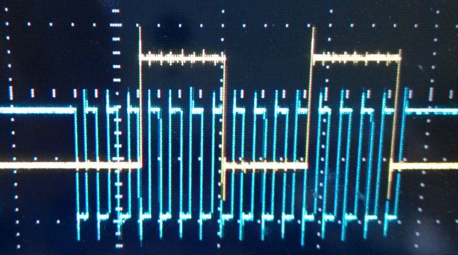

Posted on June 13, 2014 at 04:14
use MCU SPI MODEL , I have used oscillometer test.
write @0x20=0x00
read  @0x20=0x1e
write @0x20=0x84
read  @0x20=0x1e
error...

Hello, I have used LPS331AP in SPI and I2C mode for first test some months ago.
Due to LPS331AP limitation I wait the new LPS25H evb STEVAL-MKI142V1.
I try to read WHO_I_AM register but I do not reply the expected value 0xBD, I read =0xFF in I2C and 0x00 in SPI.
Source code are the same for LP331AP, what's wrong with LPS25H?
Dear Cheng, have you solve your problem very similar to my?
Thank you.
maurizio23
February 6, 2015
Posted on February 06, 2015 at 18:19
Dear All, my problem is solved. It was STEVAL-MK142V1 with LPS25H damage.
This mean that if the SDA SCL driver is damage it reply with dummy value from WHO_I_AM register..
Now second STEVAL it works on I2C bus.
Regards
Maurizio
