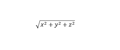

I read that this formula :
should give a constant result (even if we move the board). x, y and z should change, but not the result of this formula.
But maybe I missintepretated the information.

The readings from a magnetic field is difficult to use. If you want your equation to hold, your sensor must be calibrated to remove the offset and apply scaling factors. This calibration is nontrival. For example, here is a 30 page manual for how to do it on one device:
https://www.mouser.com/pdfDocs/MagneticCalibrationManual-2.pdf
On this device, calibration would be setting the OFFSET_X_REG values to the midpoint of the values obtained when rotating the sensor in a circle among all orientations.
