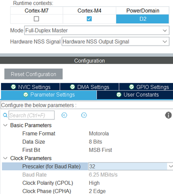

The SPI communication is setup as follows:

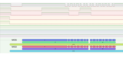

}When I observe the MISO and MOSI with a logic analyzer, I can see that good register value is sent, but I have random 0s and 1s as a return of MISO. Here is a picture of how it looks:

The MOSI line first byte is 0b10101110 which is a read of register 0x2E. That's not the WHO_AM_I register. The WHO_AM_I register is at 0x0F.
You should also uncomment the CS line commands. Not using them can get you out of sync with the chip.

Here is a better screenshot of the logic anlyzer when a query for the WHO_AM_I register is sent:
In this configuration, MISO is not reading the value of the WHO_AM_I register. Am I supposed to send another address through MOSI to get the correct return information?
CS line is commented because I setup for the hardware (STM32H745) to manage the connection. If I uncomment it, my sending information are not correct and I know that for sure I can not read the WHO_AM_I register, as in screenshot below.

Toggling a GPIO should work as expected. If it doesn't, perhaps the pin isn't configured, or is hooked up to something else, or isn't what you're monitoring.
What you're doing should work. Send two bytes and the second received byte has the response.
