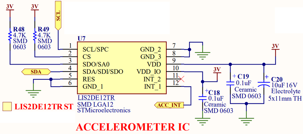

We are going to use LIS2DE12TR accelerometer, in our ultra low power device, to wake on motion.
Here is schematic for LIS2DE12TR,
Our requirement :
1) ultra low power consumption
2) Wake MCU on Motion by INT_1 Pin
Below are queries regarding schematic:
1) What should be value of R48 and R49.
2) Is schematic is ok?
Thank You
Federica Bossi
Hi @DBhut.1​ ,
Yes, the schematic is ok.
The two resistances are not mandatory, you can choose the value you prefer.
