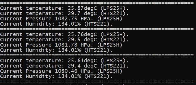

return round(humidity,2)Here are the readings that I got, when the heater on the HTS221 was turned off:

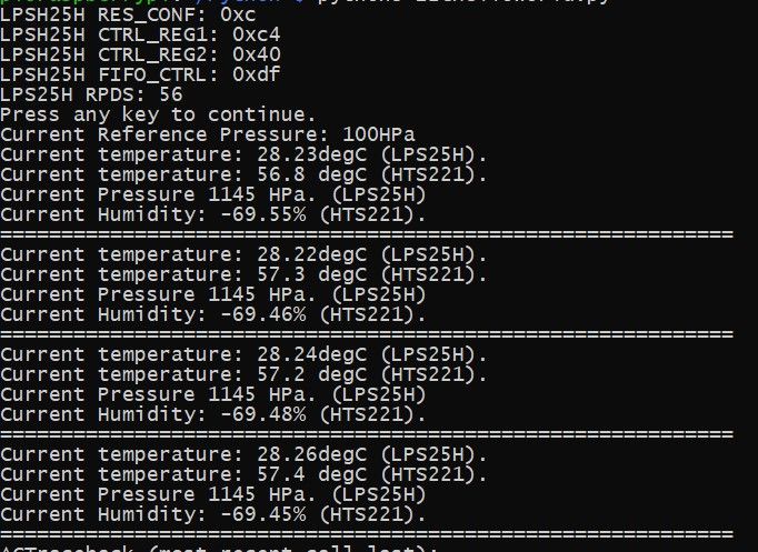

Here are the readings that I got, when the heater on the HTS221 was turned on:
I would be really great-full, if anyone can shed some light on the issue and let me know what's wrong.
2019-10-21 8:54 AM
Hi @Faizan Cassim , but does the second picture (heater ON) refers to data after the activation or during the heater on? Please note that the datasheet says that:
"valid data can be read out once the heater has been turned off, after the completion of the heating cycle", so you have to read the data after
Not clear also the reference pressure at 100hPa... are you in a low pressure ambient?

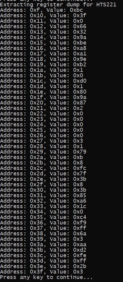

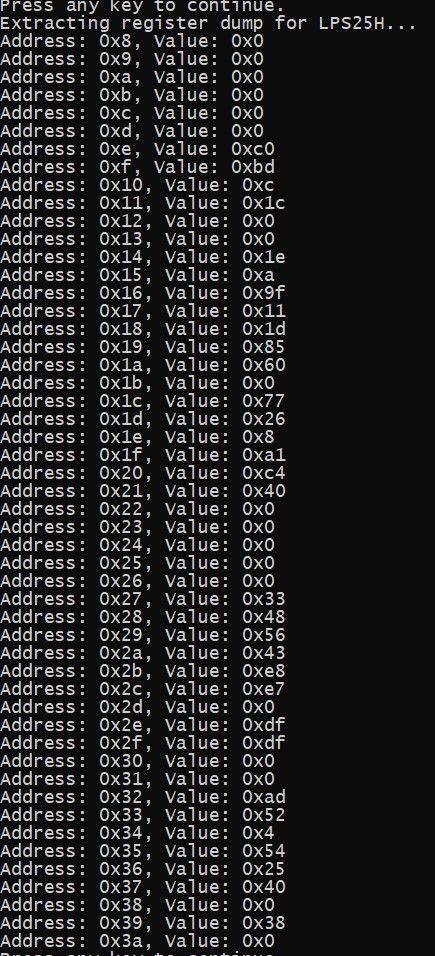

About the humidity value: the humidity formula seems ok, but the value is stuck... can you share the regmap dump and the rawHum register values?

Register Dump for LPS25H
Register Dump for HTS221
