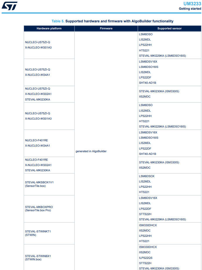

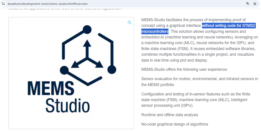

I am trying to connect the custom board to the mems studio to measure the euler angles and to explore the mems studio? is it possible to connect the custom board?
To do that, you'd need to implement the protocol to communicate with MEMS Studio.
I'm not sure ST Publishes that - it looks like it's all done by the Algo Builder:
https://www.st.com/resource/en/user_manual/um3233-getting-started-with-mems-studio-stmicroelectronics.pdf#page=23
via: https://www.st.com/en/development-tools/mems-studio.html#documentation
One of the key claims for MEMS Studio is that is works, "without writing code for STM32 microcontrollers":

I am using the stm32wb55rev6 controller can i directly connect it to the mems studio.
