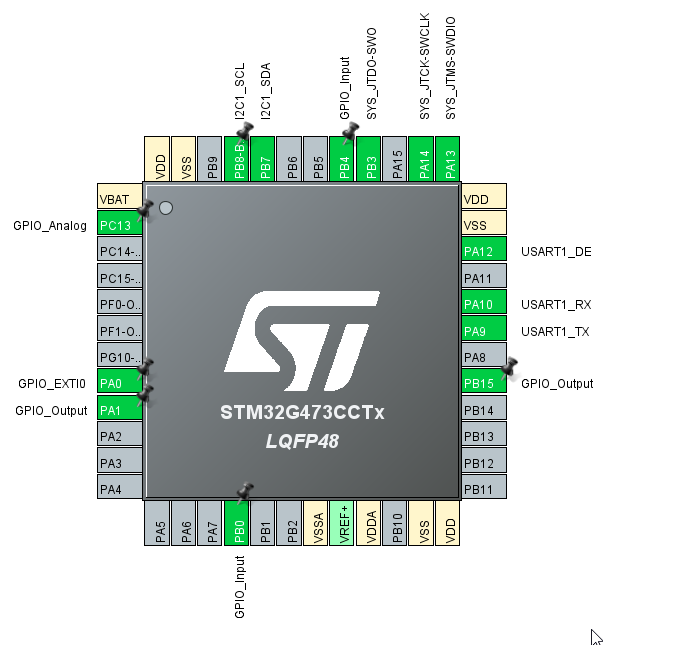

I want to implement the vl53L3cx onto my own board , using CUBEIDE , HAL driver and an STM32G473CCT6 controller.

I followed that manual, and I was running in short order, but I had a hardware guy making sure my configuation of the I2C and the interrupt lines were correct.

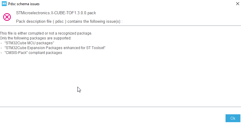

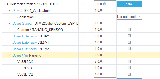

I can't select any of the support options in cubeMx ?
Where can we get some support for this?
