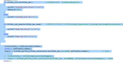

   follow  can  make offset calibration?Place the object 14cm away .Must be in a dark environment?

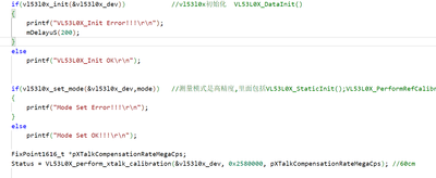

follow can make Crosstalk calibration?   Place the object 60cm away.

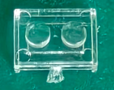

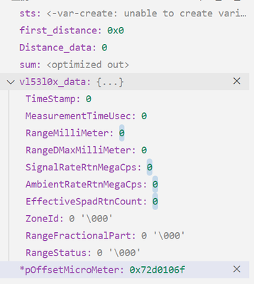

my coverglass like follow,The measured distance seems very short. How can I solve this problem?

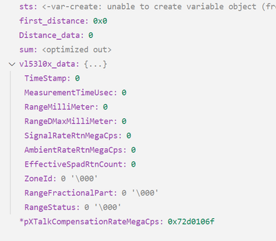

follow is my read out data

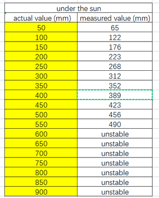

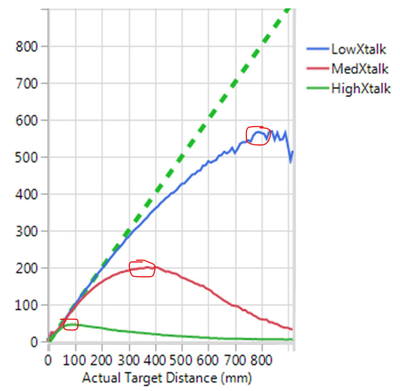

About offset calibration, normally we suggest do offset calibration at short distance(10cm or 14cm) with white target (88% reflectance) in dark condition.
About xtalk calibration, can you share your ranging data in dark condition? normally we suggest do xtalk at reorted distance start to drop, refer below picture.
And you shared ranging data is under the sun, VL53L0CX ranging ability will decrease with IR noise increase, as sun also contain 940nm noise, so sun light will impact VL53L0CX max ranging ability
you can refer UM for more detail.

Hi,dear Zhiyuan.Han
  follow is offset calibration value:14cm
follow is talkcross calibration 60cm  not under sun

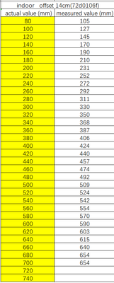

  I positioned the glass cover in front of the sensor and performed offset calibration at 14cm. The actual and measured distances are as follows. Where should I perform the CROSSTALK calibration?
When there is glass in front of the sensor, if the sensor is not well calibrated, the cover glass will be detected as target, that's why you will receive the abnormal interrupt.
you can check the range status, if status is not 0, then you can discard the data.
and you can also try to play with interrupt, below options are available:
No Interrupt
Level Low (value < thresh_low)
Level High (value > thresh_high)
Out Of Window (value < thresh_low OR value > thresh_high)
Zhiyuan.Han
Hi
From the data seems your calibration is not succeeded, or you forgot set the offset value after rebooting, normally after doing offset, if you do range measurement, the reported distance will be around 140mm, but your measurement data is 170mm.
Anyway, from your test result, I suggest you do xtalk between 650~700mm.

Hi,dear Han
  every power up ,I must run
VL53L0X_Error VL53L0X_set_offset_calibration_data_micro_meter(VL53L0X_DEV Dev,
        int32_t OffsetCalibrationDataMicroMeter)
