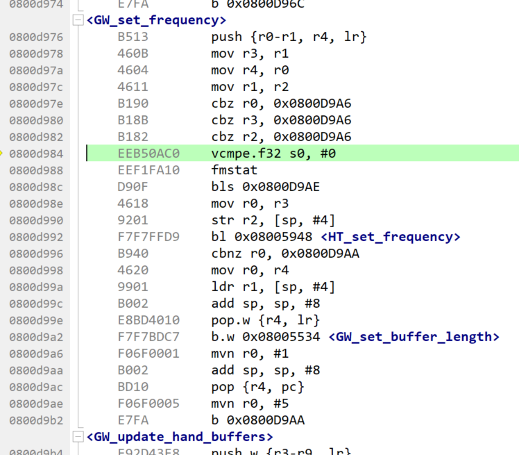

Hello, I am trying to get gesture detection (swipe UP, DOWN, LEFT, RIGHT) with the VL53L8CX working on an STM32U575 running an RTOS.  I currently have a X-NUCLEO-53L8A1 plugged into a NUCLEO-U575ZI-Q board running Segger embOS in a C++ project.  I have been able to successfully configure and collect ranging data from the ToF sensor by extracting and modifying the example code in en.STSW-IMG040.zip\VL53L8CX_ULD_driver_1.2.1\Examples\ and using HAL_I2C_Mem_Write() and HAL_I2C_Mem_Read() for the implementation for the platform WrXxx() and RdXxx() functions.
However, when I try to use the GestureKit ULD in en.STSW-IMG035_M33.zip and code extracted and modified from the example in en.STSW-IMG035_F401.zip\VL53L5_GestureKit_ULD_1.5.0\Example\Gesture\gestures_example.c:
gesture_library_init_configure() fails because GW_set_frequency() fails with error -6, indicating that the frequency is invalid. The supplied frequency is the default of 20.0 (calculated from 1000.0/Params.RangingPeriod, Params.RangingPeriod is DEFAULT_GESTURE_APP_RANGING_PERIOD = 50ms).
As a quick test, I ignored the those failures and it resulted in a Hard Fault in GW_run() in HT_update_path().

I figured out the strange issue with the library.  I created a test function that I could build and run in both environments to reproduce the problem and compared the disassembly.  I noticed that there were no floating point registers referenced in the code at all.  The other compiler defaults to soft floating point support, when I changed to hard floating point support it started working as expected.  I'm glad it was something simple.

There is a basic check in the library on the input frequency : "if (freq <= 0) return -6"
It means that the param freq is not correct (or you are not supporting the float type).
Maybe you can try to print your param before calling the function:
MZ_TRACE("freq : %f \n",1000.0/Params.RangingPeriod);

Yes, the frequency is a float with the value 20.000000.
I took a step back and verified that I could build and run the GestureKit example on the NUCLEO-F401RE using the XNUCLEO-53L8A1; it was able to recognize hand gestures as expected.  Then I started comparing the code in my project to the code in the GestureKit example.  The calls look to be the same and in the same order, the only differences seem to be that I am using the Cortex-M33 gesture library and the VL53L8CX_ULD_API (VL53L8CX_1.2.1) instead of the VL53LMZ_ULD_API (VL53LMZ_2.0.7) provided in the GestureKit.

I think I may have found a work-around for now.  I still need to do more testing to verify the full operation, but this allowed me to move on with my development and all of the subsequent API calls succeeded.
I started digging into this by stepping into the assembly for GW_set_frequency() and I noticed that the frequency parameter was not being loaded into the floating point register s0 before the vcmpe comparison (s0 always contained 0):
So I tried adding an inline assembly instruction to load the s0 register before the call, and it worked:
float freq = 1000.0/Params.RangingPeriod;
asm("vmov s0, %0" :: "r"(freq));
status = GW_set_frequency(&gest_predictor, &hand_tracker, &sensor_data, freq);
I'm not sure how this would happen, is it just a bug in the libGesturesMZ_m33.a library?

Glad to hear you figured out the compile issue. Who would have thought a compiler would default to soft floats when the processor had an FPU? That was a good find.
