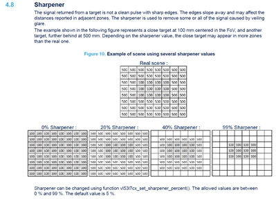

Zhiyuan.Han
Hi
Sounds like your issue is sharpener related, you can try to play with the sharpener to see if help.
Br
Zhiyuan.Han
