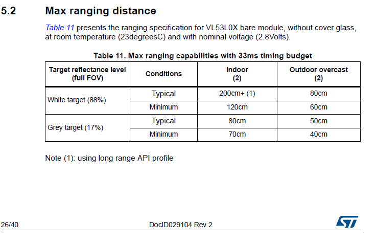

I have read in the documentation that if if you will go to use the sensor in a dark enviorement you need to configure the sensor like long range, but in this configuration I can't get a stable measurement.

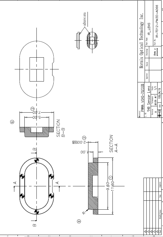

I'm use the coverglass indicated by the documentation:
On the other hand, what are the limits to measure on a dark background?
Because the values ​​that appear in the documentation are on white or gray backgrounds.

8190+ are the numbers we put into the distance return when something goes wrong.
Read the RangeStatus register and figure out what is happening.
Black is the hardest thing to range on. White returns more photons and thus can range at a much further distance.
So painting the target white is a great idea if you can.

But if you use that hornix coverglass, you will likely not need the crosstalk unless you want to be very accurate.
