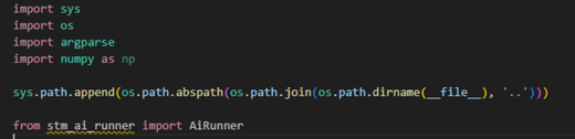

If you get an error saying that st_ai_runner module is not found, edit the checker.py like this:

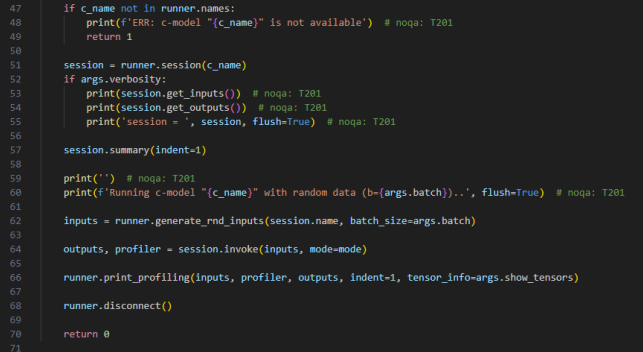

Back to the tutorial, first open checker.py:
  • Comment the line 62 and replace it to load your dataset: inputs = np.load(“./dataset.npy)
  • Save ‘outputs’ after the line 64 with something like: np.save("./ output.npy", outputs)
  • Comment line 66
  • Run again the checker.py and you should get the output saved.
