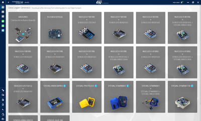

so, i have been using nano edge ai since a long time. but now i cannot log the signals when i am trying to. will they be any reason for that. please, solve this.

Are you sure that the right COM Port is selected? Are you able to log in another tool like Putty or Tera term?
Just in case, you need to send the signal via serial.
You can also take a look at the Data logger generator; you may be using a compatible board:
https://wiki.st.com/stm32mcu/wiki/AI:NanoEdge_AI_Studio#Datalogger
The source code can be found here: GitHub - stm32-hotspot/stm32ai-nanoedge-datalogger: STM32 Application for datalogging feature with NanoEdge AI Studio
