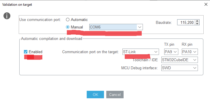

I'm a newcomer in the STM32 machine learning world and I tried to make a AI model work on my STM32F429I-DISCO. Unfortunately the "Validate on target" option does not work... Errors are E200 and E801. Here is my thought process :

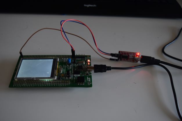

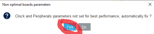

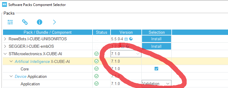

Iinstall a ftdi to my board to send data trough serial port : 0693W00000NstnmQAB.jpgThen I launch stm32cube mx, select the board STM32F429I-DISC1 and start project without initialize all peripheral with their default mode. Then :

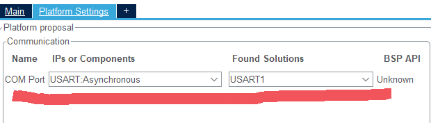

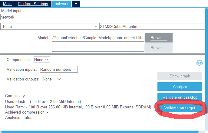

0693W00000NsttGQAR.png0693W00000NsttWQAR.png0693W00000NstXlQAJ.png0693W00000NstxmQAB.pngAnd finally :

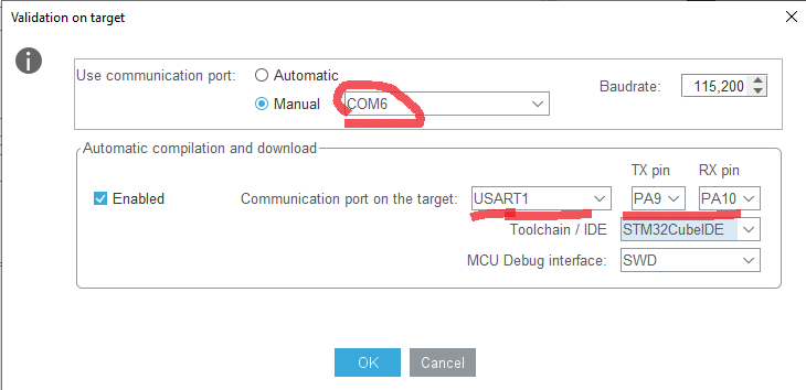

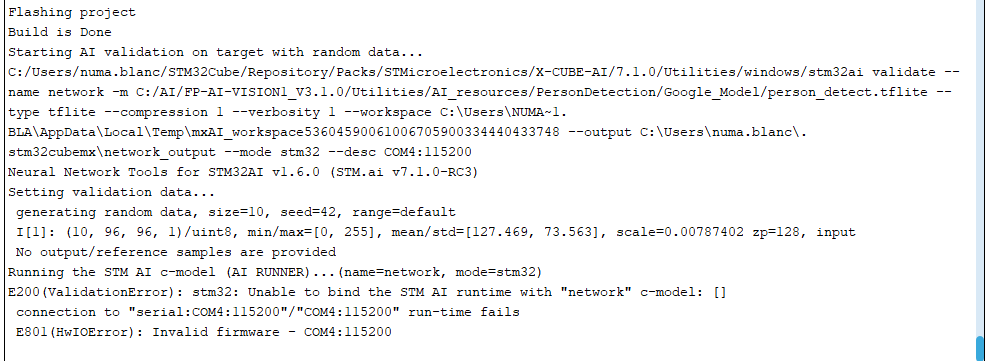

0693W00000NstzxQAB.pngI also tried validate on target on my other COM (COM4) and with communication port on the target : USART 1.
Each time I get the same result :
0693W00000Nsu2NQAR.pngI don't know what to do, can someone know the solution of my problem ?

Then you need to modify the configuration in STM32CubeMX to use the correct USART in asynchronous mode (i.e. configure by hand the USART and set the correct platform settings in X-Cube-AI to point to the correct USART)

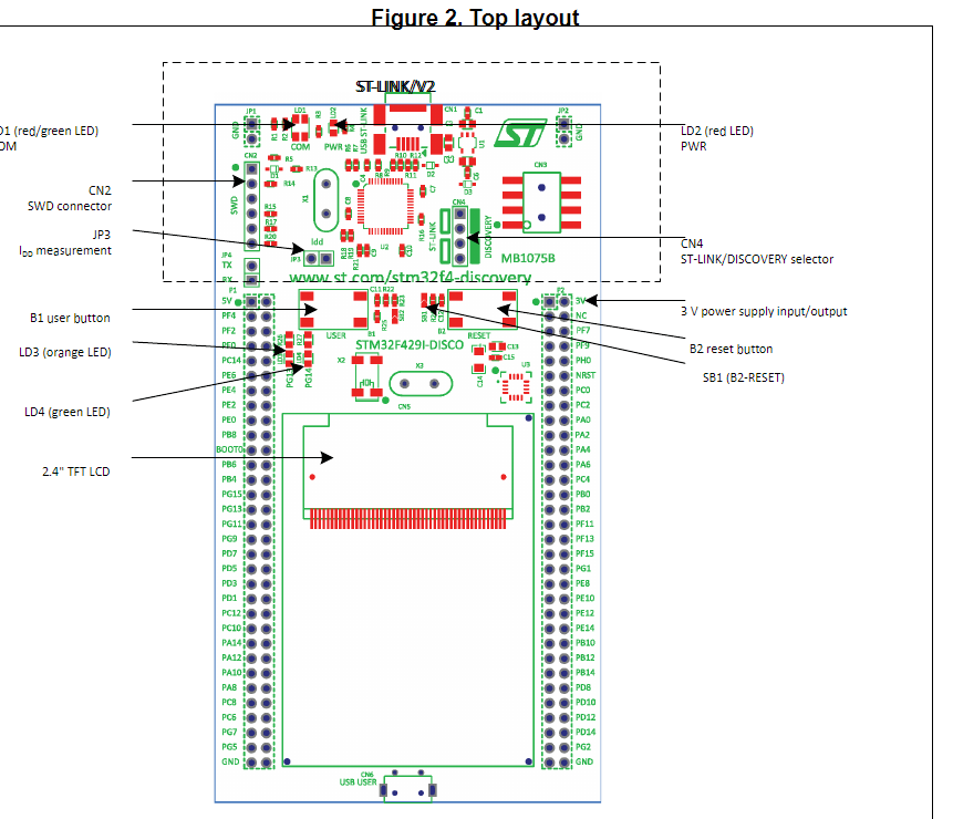

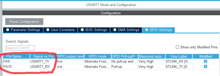

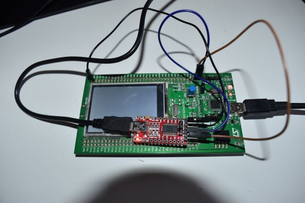

I have already installed a ftdi (red board on the photo) and connect it as such on my board :0693W00000NswmmQAB.jpgAnd I was already setting my USART1 on PA9 and PA10 :0693W00000NswjKQAR.png0693W00000NswuWQAR.pngBut still, same errors as before, I will downgrade to a more ancient version, maybe that's what causing a problem.

If your ftdi is correctly connected you should have at least a message on the pseudo terminal
I must look at the wrong user manual but for me PA9 and PA10 pins on the boards are more close to the LCD
Maybe you could also try to swap the rx/tx pins on your ftdi
Regards
Daniel
You were right, I was inverting my RX and TX, now I can message on my terminal when resetting my card. Unfortunately I have the same problem as before... but little bit by little bit we're advancing.
