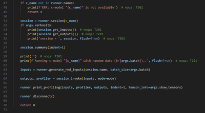

The AI runner can be found here: \ST\STEdgeAI\2.2\scripts\ai_runner
  • First, you need to install the requirements: pip install -r requierement.txt.
  • Then you need to load the validation firmware with the n6_loader.py (which assumes you did the generate)
  • Open a git bash (in ai_runner folder) and run:
    export PROTOCOL_BUFFERS_PYTHON_IMPLEMENTATION=python
  • Then run: python ./example/checker.py -d serial:921600
By default, the AI checker do…
But you can edit it to:
  • Load your dataset (npz)
  • Save up the outputs
To do so, open checker.py
  • Comment the line 62 and replace it to load your dataset:
    inputs = np.load(“./dataset.npy)
  • Save ‘outputs’ after the line 64 with something like: np.save("./ output.npy", outputs)
  • Comment line 66
Run again the checker.py and you should get the output saved.

Thank you for your reply. I believe I have identified the root cause of the issue: I had not configured the NPU option in RIF. After enabling it, all outputs now fall between 0 and 1.
