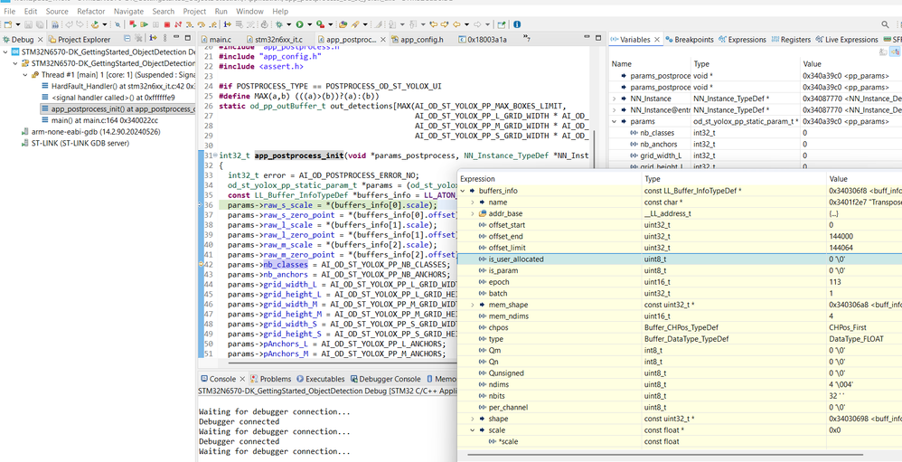

I have build a custom model based on st yolox model.
This model have an input of 480x480. Intput int8 and output float.
Five classes for vehicles detection
Quantized and tested on stm32N6570-DK.
Now i'm trying to add my model on this st example
https://github.com/STMicroelectronics/STM32N6-GettingStarted-ObjectDetection/tree/main
I'm following this tutorial to deploy my model
https://github.com/STMicroelectronics/STM32N6-GettingStarted-ObjectDetection/blob/main/README.md#application-build-and-run---dev-mode
I'm using stm32cubdeIDE to program the card
After i programmed the network_data.hex, i'm trying to deploy and debug the application.
But i have this error at this step : app_postprocess_init
The parameters
Do you have en idea how i can resolve this ?

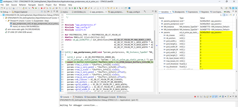

Hi @mls,
Did you edit the app_config.h and the post processing for your model needs?
Please look at this document:
STM32N6-GettingStarted-ObjectDetection/Doc/Deploy-your-tflite-Model-STM32N6570-DK.md at main · STMicroelectronics/STM32N6-GettingStarted-ObjectDetection
Have a good day,
Julian

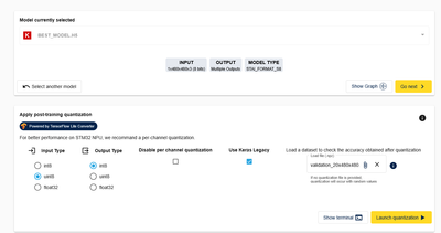

I found the solution for my first issue ! I quantized a model in int8 (input) and float (output)....not supported in your example.
I quantized my model in uint8/int8
#define POSTPROCESS_OD_ST_YOLOX_UI (106) /* ST YoloX postprocessing; Input model: uint8; output: int8 */
Downloaded the model in the card and launch the debug
Now stuck in Run Inference
A question ? does the model need to be quantized in input in UINT8 or it could be INT8 ?

I think your issue is maybe due to a conflict between the input and output type your model use, you used in the generate command and what the firmware expect (as described in app_config.h)
Can you share the exact command you used (the generate) and your app_config.h
Also, if you can share your model, it would be helpful (in private message if you want).
Have a good day,
Julian

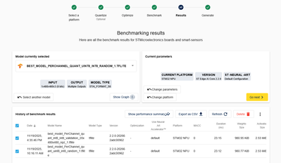

Unfortunately for the moment i don't have access to my GPU server (thank you OVH ...) that i used to train the model.
That i did today is to quantize my model (h5 file) with ST Edge AI Developer Cloud.
All the process is ok
See here the app_config.h
I will send you the model by private message

Hi @mls,
manual deployment:
  • copy your model: STM32N6-GettingStarted-ObjectDetection\Model
  • Run the following commands
stedgeai generate --model your_model --target stm32n6 --st-neural-art default@user_neuralart_STM32N6570-DK.json --input-data-type uint8 --output-data-type int8
cp st_ai_output/network.c STM32N6570-DK/
cp st_ai_output/network_ecblobs.h STM32N6570-DK/
cp st_ai_output/network_atonbuf.xSPI2.raw STM32N6570-DK/network_data.xSPI2.bin
arm-none-eabi-objcopy -I binary STM32N6570-DK/network_data.xSPI2.bin --change-addresses 0x70380000 -O ihex STM32N6570-DK/network_data.hex
  • use STM32CubeProgrammer to flash the weights in STM32N6-GettingStarted-ObjectDetection\Model\STM32N6570-DK\network_data.hex
  • Edit STM32N6-GettingStarted-ObjectDetection\Application\STM32N6570-DK\Inc\app_config.h
In your case, you have 5 classes and are using a yolox with input shape 480x480:

 Finally, open the cubeIDE project to build and run it
With Model zoo:

please note that you can have any input and output type for your model. When generating the C model, the model is edited to have uint8 input and int8 output:
stedgeai generate --model st_yolo_x_nano_480_1.0_0.25_3_st_int8.tflite --target stm32n6 --st-neural-art default@user_neuralart_STM32N6570-DK.json --input-data-type uint8 --output-data-type int8
Then you need to use the  POSTPROCESS_OD_ST_YOLOX_UI postprocessing
In the model zoo yaml, you should take a look at the postprocessing, mainly the number of boxes and the threshold.
Have a good day,

Hi Julian,
Thank you  for your answer. Just tested your flow but same result. Whit my model it didn't work ..
Have you tested with my model ??
Julian E.
December 12, 2025
@mls, yes I think, except if I did a mistake...
Your model are best_model_PerChannel_quant_int8_float32_random_1 and best_model_PerChannel_quant_int8_int8_random_1 correct?
Could you try to clone the repository again to make sure we are aligned?
