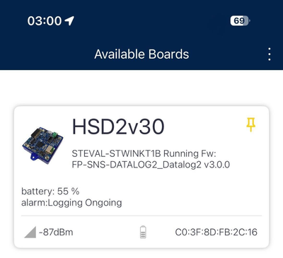

I monitored the logger as much as possible. After 8 hours, the green LED was still blinking, and the ST BLE Sensor app showed:
Alarm: Logging ongoing
Battery: 55%
(see screenshot below)

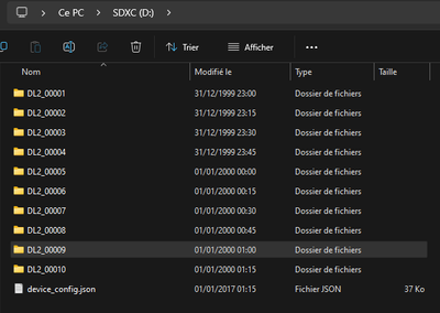

However, when I checked the SD card, I only found about 2.5 hours of data, specifically, 10 folders of 15 minutes each. But I expected at least 8 hours of logging.
So my question is: Why do I only get a few hours of logged data, even though the logger appears to be active (green LED blinking) for much longer?

  • Here's the battery level over time during the abovementionned test:
    • 0h: 95%
    • 5h: 65%
    • 5h15: 61%
    • 6h: 60%
    • 6h30: 58%
    • 7h46: 55%
