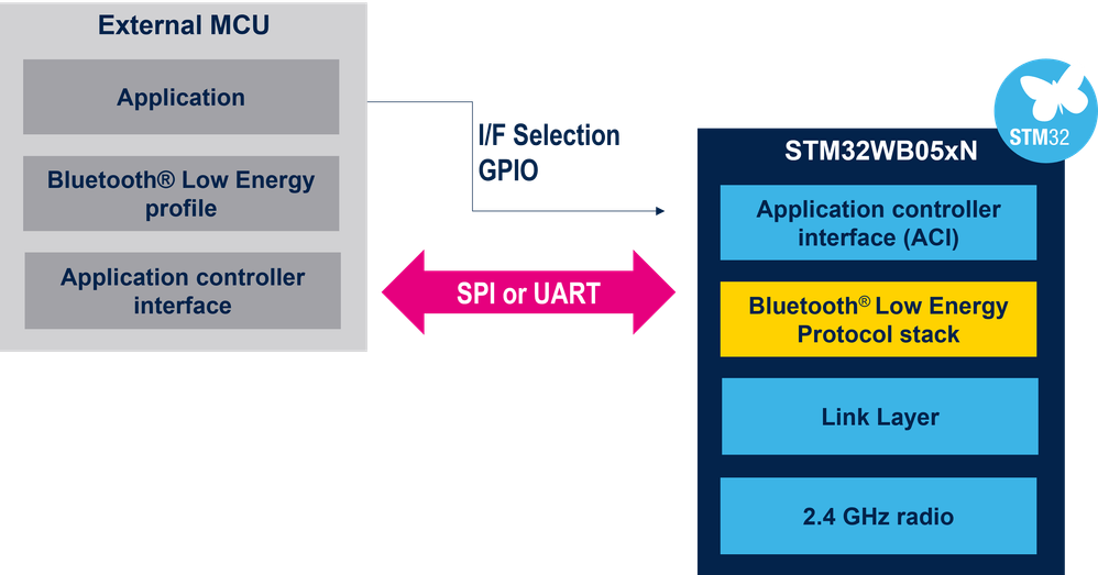

The STM32WB05xN network coprocessor is the most affordable STM32 device for implementing wireless connectivity in any embedded application. Just like the other products in the series, it features a +8 dBm output power and a sleep current consumption of 800 nA. It also comes with a precompiled and certified Bluetooth® Low Energy 5.4 radio stack developed and maintained by ST. The network coprocessor delivers the essential wireless performance features, including 2 Mbps data rate, coded PHY, advertising extensions, and AoA/AoD direction finding.
Its SPI and UART interfaces allow for communications with the host microcontroller or microprocessor running the main application. The host MCU or MPU and the Bluetooth® Low Energy subsystem can be updated independently, which provides greater simplicity in handling device lifecycles as well as full hardware scalability and software design flexibility, depending on the host capabilities.
