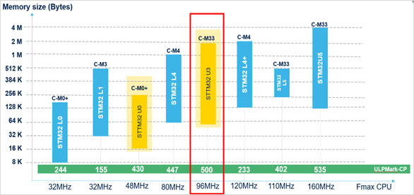

These are the first STM32 MCUs based on near-threshold technology, delivering a breakthrough improvement in battery life. With near-threshold technology, the STM32U3 MCUs reduce the active consumption down to 9.5 μA/MHz, resulting in significant longer battery life for any application.
Powered by an Arm® Cortex®-M33 core running at 96 MHz, it delivers market-leading energy efficiency—up to 5 times better than previous generations, with 117 CoreMark/mW.

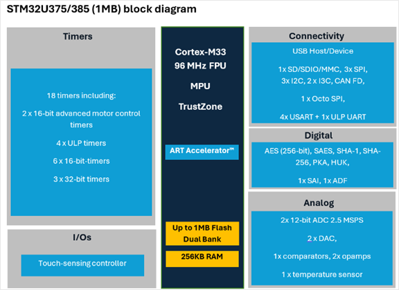

Flexible memory and packaging
With flexible memory options (256 Kbytes of RAM & up to 1 Mbytes of dual-bank flash) and a wide range of package choices, STM32U3 enables you to build compact, power-optimized devices tailored to your needs.
Enhanced security for mission-critical applications
Security is a core focus of the STM32U3, targeting PSA Certified Level 3 and SESIP Level 3 certifications to provide robust protection for sensitive and mission-critical systems.
Its dual-bank flash architecture supports seamless firmware updates without system downtime, an essential capability for safety-critical environments.

  • For applications requiring 3% of runtime time:
    The STM32U3 is 2.2 times more energy efficient than the STM32U5
  • In metering applications:
    The STM32U3 delivers 1.4 times better energy efficiency compared to the STM32U5
  • For applications with very low activity (0.04% runtime) and mostly in Stop mode:
    The STM32U3 still achieves 1.2 times greater energy efficiency than the STM32U5
Even with very low duty cycles, the STM32U3 consistently outperforms the STM32U5 across different application profiles, whether consumer, metering, or industrial, making it a better choice for energy-sensitive projects.

STM32U3 block diagram
