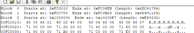

why SPC58NN can not be connected anymore?
Yqiu.1
0693W0000059dc7QAA.pngmy dear guys, I download a hex into MCU by UDE tool, but after doing some reset action ,it can never be connected anymore, could be pls help me to review the memlay of this hex file and does it destory some key area or contents of the flash ?

it could be that due to some wrong flash programming the device is not able to exit form reset.
Configure the debugger to attach (instead of connect) to a running device and then reset the device.
Use the Target Configuration menu (in UDE PLS interface) to do so.
Regards,
Giuseppe
thank you pretty much ,the SBC is enable in the plant state even if I do not plug in KL15(I only plug in KL30) ,but after I download SW and re_initial SBC, the SBC will not power on MCU if I don't plug in KL15.
so this is a fool mistake made by me.
