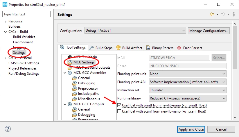

I have some problems with printf function.
For example,
float valf=0;
printf("%.0f",valf)
The result is
f
I don't understand...I thought that the native printf worked...
The option
Use float with printf is flagged.
Thank you.

Do you enabled float output in CubeIDE?

In your IDE, compiler configuration, check icon "nano printf" for float variables.

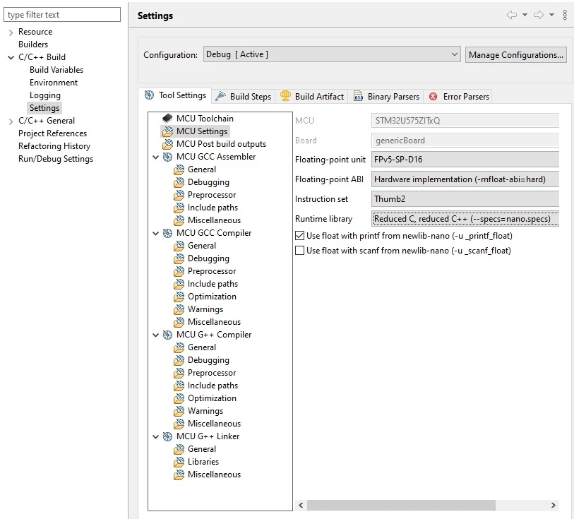

ONadr.1
Senior III
March 20, 2023
IVent.1
IVent.1Author
Senior
March 20, 2023
Attached my compiler configuration.
IVent.1
IVent.1Author
Senior
March 20, 2023
The problem was a writing in flash (I'm using a nucleo-board). How to know the part of the flash you can write to?
