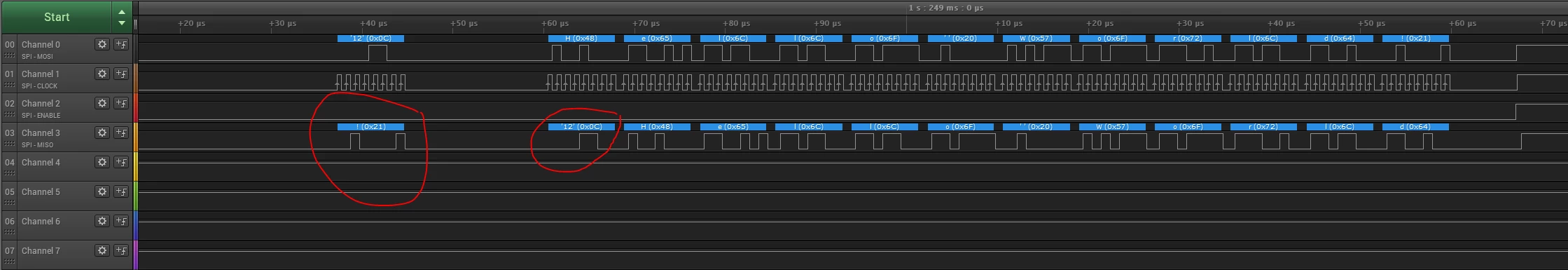

WHY MISO ECHO BACK WHAT MOSI SENT, EVEN THE MISO PIN IS ALREADY DISABLED.

I make a code that is just send SPI data, and the MISO should not return anything. Here is my code:

So, there should be no any SPI receivedata from MISO, but when I look the data at the logic analyzer, the MISO sent back the data from MOSI. It is like echoing, Or Is it because of the SPI nature?
this code I sent "Hello world!" the string length is 12.
First, I send the length of the string to the slave, Then, I send the Hello world! sentence to the slave.
the thing is, every data transmit from the MOSI, there will be a data sent back from MISO which is the sentence of the Hello world!
example in my picture, when I send the length 12, the MISO will exchange the " ! ". which is the last letter of hello world!
Then, when letter H is being sent, the MISO will reply back the length of the string data which is sent previously. Why is this happening? anyone can help me?

CAN YOU TELL US WHAT HARDWARE ARE YOU USING?
MAYBE A NUCLEO BOARD?

Yes, Im using nucleo board stm32F302R8 as my master, and slave is arduino UNO

i love your oscilloscope, you have any analog channels available?
you should measure analog AND digital MISO and MOSI at the same time, maybe you see some noise false triggering your gpios----
MISO means Master-In-Slave-Out, so it's the slave (i.e. the Arduino) which drives the MISO line, not the STM32.
May 10, 2021
"nothing" is not an option. It's a digital line, it can be either 0 or 1. But whatever it's doing is defined by the Arduino code and not the STM32.

Actually, im following stm32 course from udemy, so the arduino code is provided from the instructor. Here is my arduino code, in the void loop, the slave will receive the data at the line:

waclawek.jan
May 11, 2021
In AVR (ATMega8 or whichever you have in the Arduino), SPI is a true 8-bit shift register, so if it is set to slave, with no writing to it, this is exactly how it behaves, i.e. MISO copies MOSI with an 8-bit delay. Read the AVR datasheet SPI chapter.
WM_IR
WM_IRAuthor
May 12, 2021
So, does the copied data from MISO is stored into my master Data register? If yes, do I need to clear it with dummy read in master?
