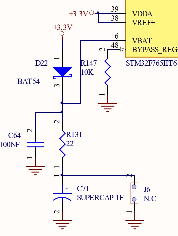

I experience a problem when the capacitor is fully discharge. When the program try to read from a UART port it stall on the read command and the application will not continue.If I put a delay before the read for the time that it takes the capacitor to charge to 1.8V then the read is successful and the application continue.
Is there is any explanation why the low voltage halt the reading from UART when VBAT voltage is below the 1.8V?
Thank you.

waclawek.jan
February 26, 2020
You mean, a supercap on the VBAT pin? Post relevant part of you schematics (power supply arrangement) or a sketch of it.
Try to change the BOR setting.
Elik Livnat
February 26, 2020
Here is the schematic. If I increase the burn out I might have to wait even more until the capacitor charged.
The part I do not understand why the uart port on read command get stuck until the capacitor is charged. The capacitor should be charged in a 1 sec and the VBAT should have the threshold level in about 20mS.
Thank you.

waclawek.jan
February 28, 2020
Insert a series diode just before the VBAT pin, so that current can flow only *into* VBAT, not *out of* VBAT.
If this does not help, measure drops on VDD *and* GND during VCAP charging (replace VCAP with a short for that measurement). If there's significant drop, increase the charging resistor i.e. decrease charging current, reconsider layout, reconsider power supply arrangement.
