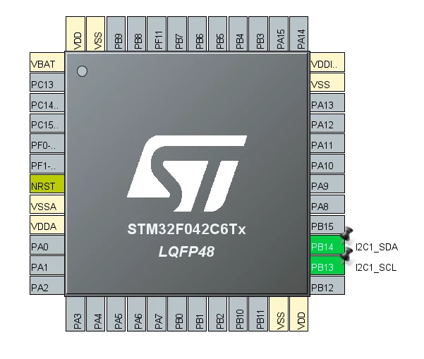

Hello, I have a SMT32F042, i'm trying to use I2C. I used STM32 CubeMX to generale a new blank project with only i2c (see attached). I2C on non standard pins. 0693W00000KcOSeQAN.pngThe problem is that they always stay low, it does not transfer anything.

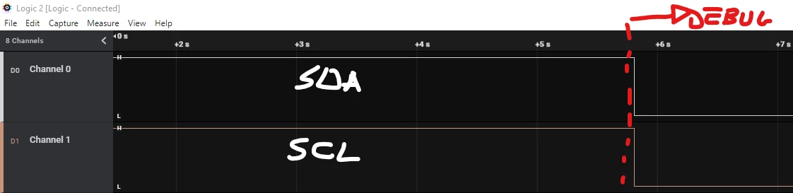

This is what I captured with the logic analyzer, after starting the debug, it goes low.

I tried also to configure everything as output pin with external pull up (9,5k) and open drain... it works, so my pull up resistor are working.
I really don't know what to check next. THe same come with nucleo works perfectly.

I tried with i2c1 normal pins (PF0 and PF1), and it worked. For my configuration (PB14+PB13) the result is still the same. I ended up that maybe is a but in stm32cube with setting alternate function. Anybody can see something strange?
