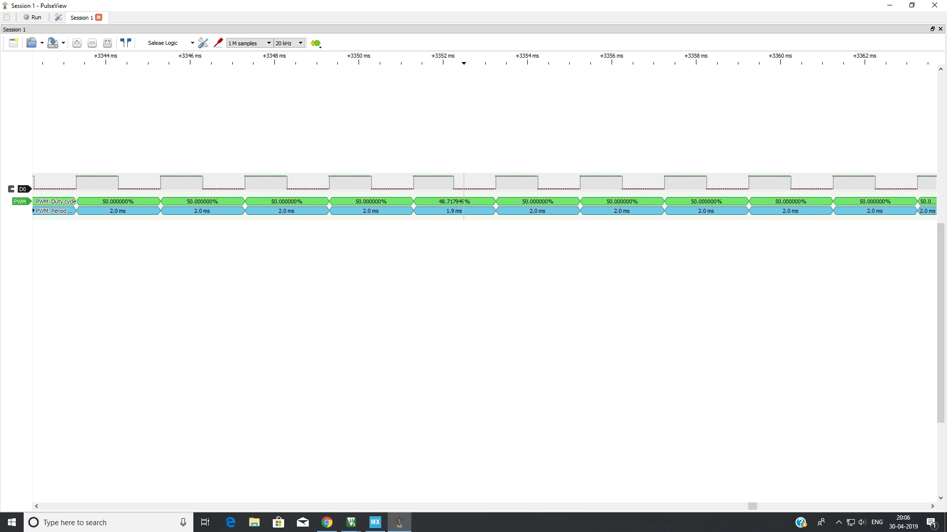

I'm trying to rotate the BLDC using PWM(50% duty cyle, 2ms pwm time period). My timer initialization code:

I've checked the pwm output in logic analyzer. The desired duty cycle and time period are coming exactly. But when I measured the pwm voltage it was showing 0.80V. Is it sufficient to rotate the motor?
I've checked the pwm voltage in arduino(same motor, duty cycle and time period). The motor was rotating and the output voltage is 2.6V.

Vangelis Fortounas
April 30, 2019
Hi.
2ms period (500 Hz) and 50% duty cycle means pulse width =1ms.
With 1ms PW the motor speed will be zero. PW=1ms-> zero speed, PW=2ms->Max speed.
But i am not sure that ordinary commercial ESCs could be driven at 500 HZ.
Most ESCs are capable 3.3v input also 5v input without problems
Should it be greater than or less than 500Hz? Anyways I've tried with 1000Hz i.e. 1ms PWM time period and 100% duty cycle. It rotated. However, it was not working for other duty cycles. Why?
How did you calculate that? please let me know.
-Aditya
Vangelis Fortounas
May 1, 2019
"How did you calculate that? please let me know."
This is the standard specification for PWM driven servos and ESCs
As a consequence PWM freq can't be more than 500 HZ (duty cycle about 100%)
Old servos work with 50 HZ freq, just check the specs of servo.
For ESCs, max_freq <500Hz. and minimum freq is 50Hz or lower.
Typical freq of 300HZ for an ordinary ESC works ok.
Try 300 HZ freq (3.3ms period) . The pulse width is 1ms(30%duty cycle) for idle speed and 2ms(60% duty cycle) for full speed.
