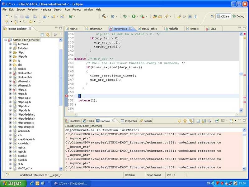

I am trying to compile a C program for STM32F4 microcontroller
with Eclipse + yagarto compiler
I get the error;
undefined reference to `_impure_ptr'
there is no function ''impure_ptr'' in whole project
the error pointer points to a line containing only     }

    mehmet.karakaya
    November 23, 2012
    Posted on November 23, 2012 at 13:12
    hello , here is a screenshot
    I searched google - it says this error is related to newlib or something like that
    however I couldnot find any answer how to solve this problem
    frankmeyer9
    November 23, 2012
    Posted on November 23, 2012 at 13:38
    Have you tried that ?
    http://communities.mentor.com/community/cs/archives/arm-gnu/msg03556.html
    mehmet.karakaya
    November 23, 2012
    Posted on November 23, 2012 at 15:39
    hello , I think you suggest me to change something here in makefile
    what do I need to change in below makefile ?

    Tesla DeLorean
    Guru
    November 23, 2012
    Posted on November 23, 2012 at 16:12
    The linker is driven by the LD and LDFLAGS lines, fix those.
