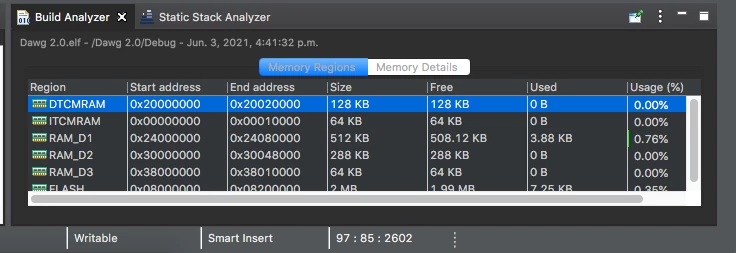

    Kept digging and found this in my map file
    .bss.I2S1_TxBUFF
     0x00000000240004ac 0x10 Core/Src/driver/I2S_FACTORY.o
     .bss.I2S1_RxBUFF
     0x00000000240004bc 0x10 Core/Src/driver/I2S_FACTORY.o
     .bss.UART4_RxBUFF
     0x00000000240004cc 0x1 Core/Src/driver/UART_FACTORY.o
    .text.getUART4_RxBUFF
     0x0000000008000f60 0x14 Core/Src/driver/UART_FACTORY.o
     0x0000000008000f60 getUART4_RxBUFF
     .text.getI2S1_TxBUFF
     0x0000000008000cd0 0x14 Core/Src/driver/I2S_FACTORY.o
     0x0000000008000cd0 getI2S1_TxBUFF
     .text.getI2S1_RxBUFF
     0x0000000008000ce4 0x14 Core/Src/driver/I2S_FACTORY.o
     0x0000000008000ce4 getI2S1_RxBUFF
    All the DMA variables are located in the ITCM memory region, could this be the problem? If so how come the DMA doesnt return any errors?
    June 4, 2021
    0x00000000240004ac is in the AXI SRAM.
    0x0000000008000f60 is in FLASH, but that's just code, not a buffer.
    Why do you think those are in ITCM?
    CLeo.1
    CLeo.1Author
    Senior II
    June 4, 2021
    Right I see my mistake now correct its in the D1 Domain, what else could it be then
