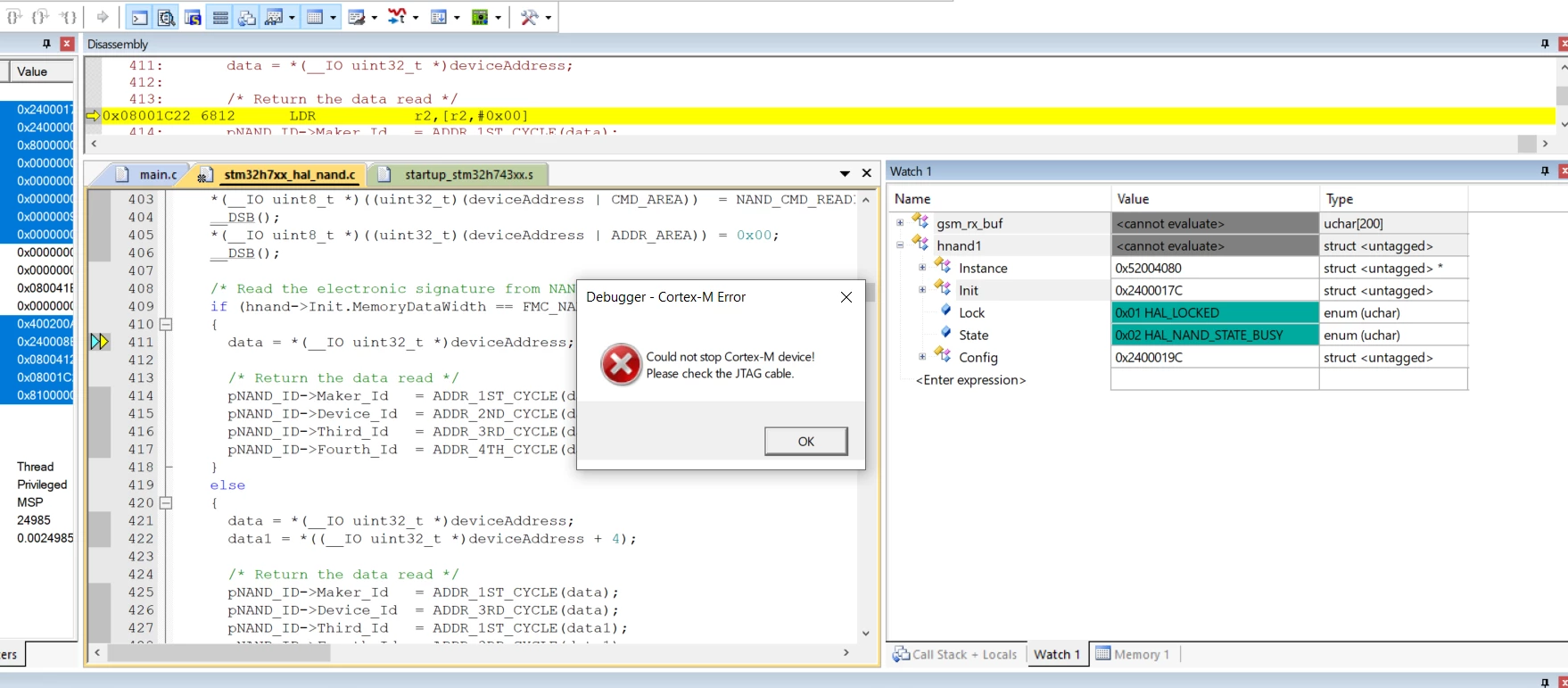

Hi
My code stops after i use the HAL_NAND_Read_ID function, Also the debugger stops working and i can see no errors to solve.
Thanks for helping me.

Hello @Arman Ilmak​ ,
Check if you have the same conditions related to the NAND Flash as described in the STM32H743xI/G Errata sheet.
If possible to share your code if this issue is not resolved, and please provide more information to understand the cause of the error.
Which Cube example did you looked to? Which Firmware version are you using ?
Are you using CubeMX for generating the code?

I use cubemx v6.3.0 as code generator and stm32h7 v1.8.0 softwarepacket.
I just config the nand timing and generated the code.
Here is the main code:

Hi @Arman Ilmak​ ,
Sorry for the delayed reply on this, I missed your reply.
I think your issue is related to the known limitation with CubeMX v6.3.0 when DMA is used: that the MX_DMA_Init() shall be called BEFORE any other peripheral initialization (Please see this post for more details).
I'll be waiting for your feedback and let me know if this solved your issue.
