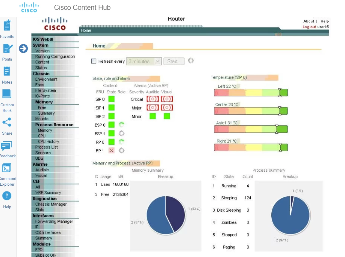

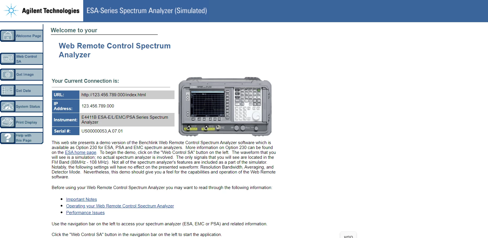

Hey
I want to make a product with WEB UI . My goal is product that will connect to my internal network and I want to be able open a browser on my computer and write the IP of the product, I will connect to its web page and I can control it.
I would appreciate recommendations on MCU/MPU that support this or development boards with enough memory to be able to contain the web page
Thank you
I am attaching pictures of examples of websites in equipment such as routers and laboratory equipment.
