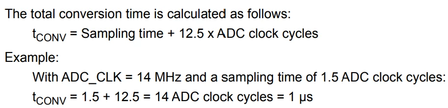

December 19, 2023
The sampling and conversion times for ADC are given in the reference manual.
Due to the overhead of callbacks and instructions, it is difficult to measure this in code.
