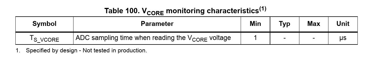

Anyway - why you care about the "real" voltage ? You can switch the level 0..3 , but the chip will do, whatever this version of chip deciding then to do. You cannot change or adjust a certain level.
If just for interest : try to measure it , with the ADC ->

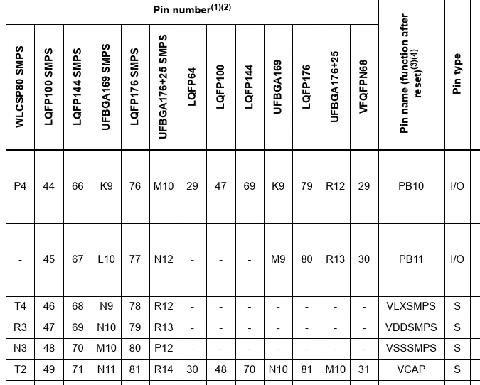

AScha.3
June 5, 2024
Maybe even faster : look at the VCAP pin (at your case) and check just with a DMM . (core voltage)
Then you see, what your chip doing . :)
