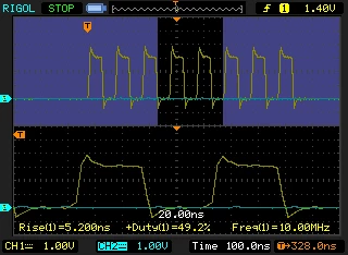

I use TIM1 in repeat and one pulse mode to generate 8 CLK for 1 byte of SPI
I have a working 10MHz 8 clock pulses on pin PE9.
I would like to set SPI1 (PB4->MISO and PB3->SCK) in slave mode and output with CLK generated by TIM1
Are there any obsticles I am unaware? Vpp voltage drops from 3,3V to about 2V when I connect PE9 to PB3. :\

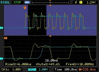

MY BAD I had wrong setting for SPI (master instead of slave). :\
Back to work now :) I think it is doable.
CPOL=0, CPHA=1, 0x7a on picture:
