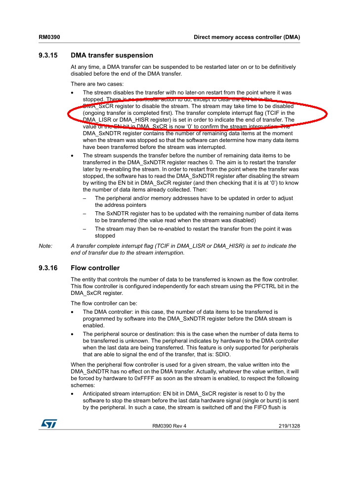

For the dual-port DMA, it *is* documented in RMs, e.g. for 'F446:
0693W000004JxpMQAS.pngIt's described also in the related AN4031, in 4.1 Software sequence to disable DMA (although with a confusing "In both cases" in a chapter describing one case... ST's documentation is not famous for being precise.).

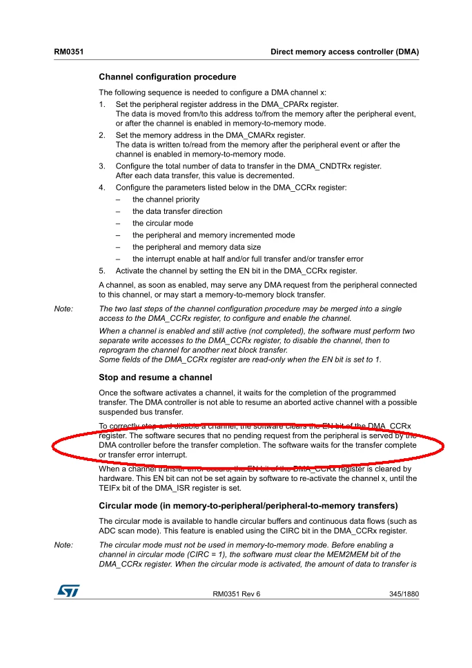

The single-port DMA has only a very confused description of the disabling process, e.g.
0693W000004JxtOQAS.png The related AN2548 does not mention channel disable.
If you don't see the interrupt upon channel abort, you have to "help" it: set some volatile variable indicating "aborted transfer" to the DMA ISR, and then force the DMA ISR using the CMSIS intrinsic NVIC_SetPendingIRQ().
