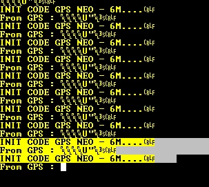

Dear Members,
I want to read a result from my GPS,
it's Neo 6M
I initialized 2 UARTs UART 1 for PC and UART 2 for GPS,
I got this result :
INIT CODE GPS NEO - 6M....
From GPS : 0690X0000087jMhQAI.png
Is it receiving properly ?
The code :
 char in[8];
printf("From GPS : ");
  HAL_UART_Receive(&huart2, (uint8_t *)in, 8, 1000);
HAL_UART_Transmit(&huart1, (uint8_t *)in, 8, 1);
printf("\r\n");
Green LED on GPS module is blinking...
Thanks

I would expect NMEA sentences at 9600 8N1
Your HAL functions block, so no ideal for forwarding data.​
AvaTar
Senior III
March 11, 2019
This are the default setting of the module.
Do you have the baudrate of the STM32 MCU set properly ?
And not changed the module's setting to binary UBX messages ?
In addition to the inappropriateness of said HAL functions.
Tesla DeLorean
Guru
March 11, 2019
Seems too consistent and wrong data to be UBX. Would need to know more about specific implementation. NAZA​ UAV modules for example output their own packet format.
One could observe data with a scope, or use USB to CMOS Serial directly from NEO-6M module.​
Tesla DeLorean
Guru
March 11, 2019
Does the receive call function or does it return an error? Try clearing the buffer and checking. Post lacks a lot of salient details which would help diagnose situation.
To answer the underlying question, No this doesn't look to be receiving properly/correctly. ​

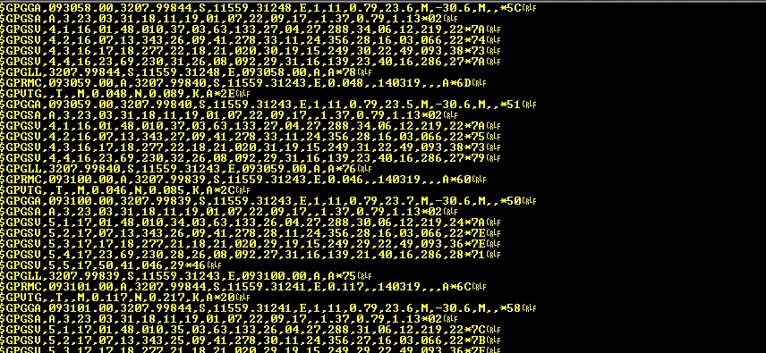

March 14, 2019
I got output from
serial to PC
May be with interrupt is better ?
