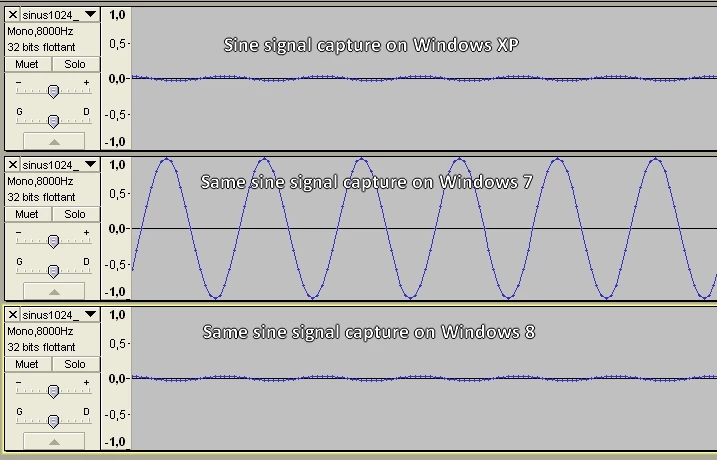

    Hi Mah,
    You have to add a feature unit descriptor and all relevant class requests(Get Min, Max, Res, Cur).

    Thank you for your reply.
    It is now working :)
