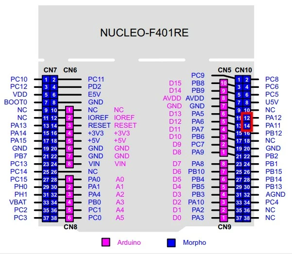

Hi there.
I have been trying to configure this USART6 on my STM32F401RE board as 9600 and Async.
But I just can't seem to figure out what I am doing wrong? I am not using the HAL for this project.
I really just want to get an example of how to use the UART6 on PortA with this MCU.
Thanks

Hi everyone
Thanks allot for the quick reply. Ok so I changed my code to send While TXE != 0 and it enters the Write function now when I step.
Problem is my USB2Serial converter has a little orange TX light indicator. BUt that never flickers or does anything when I repeatedly send one char.
SO I though I might be missing something in therms of PINOUT.
I am using these two pins on the board in the RED triangle. Those are the RX and TX pin as I have set it up right?
I believe only the PA11 pin is capable of UART6 TX?

Ok so while I was busy cutting and pasting my docs to put up here I notice that I am writing the special function register LOW and because PINA11 and 12 is on HIGH its the wrong register to write it into. So I changed line 30 from
GPIOA->AFR[0] |= (1<<15);
to
GPIOA->AFR[1] |= (1<<15);
So now I see my TX flashing and I have some output on my terminal although its not good output. The output is gibberish.

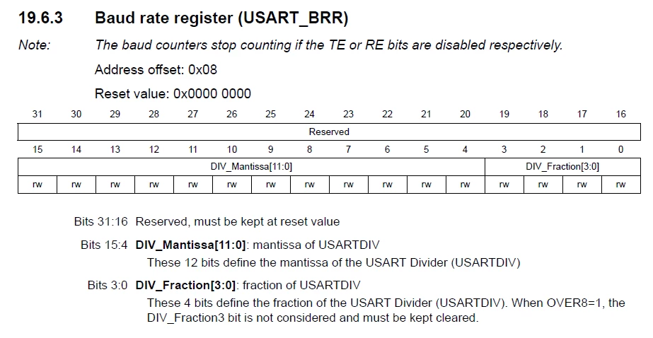

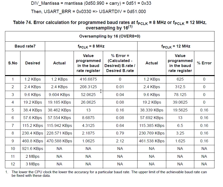

If I run a 16Mhz clock and I want a 9600 baud rate then the settings I have should work right?
  1. USART6->BRR = 0x0683; //BAUDRATE 9600 @16Mhz
  2. USART6->CR1 = 0x0008; //ENABLE Tx
  3. USART6->CR1 |= 0x2000;
Guenael Cadier
May 28, 2020
Some investigation ideas ...
0x0683 seems ok for me in BRR register for getting a 9600 baudrate based on a 16Mhz clock.
Default setting in CR1 CR2 also imply : 1 stop bit, No parity.
If your terminal is configured accordingly, could you capture (scope) a data being sent and measure the transmission time of 1 bit, and then check if it is corresponding to expected 9600, or something else ?
If not 9600, maybe the 16Mhz is not the freq available on APB2 ?
Regards
