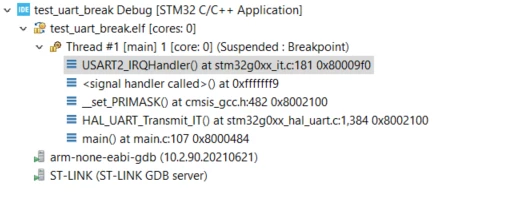

tvill.1
tvill.1Author
July 12, 2022
I add the report from cube MX and caal stack after the reset in irq handler.

Other thing, my STM32G0B0 is recognized as G0B1 (mcu sourced directly from ST) on the stlink tool.
0693W00000QL5AgQAL.pngI have soldered this mcu on nucleo32-G031K8 for my prototype and already integrated on my final design.
