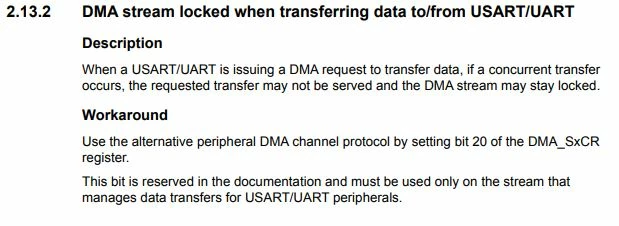

Please consider this FAQ article: DMA is not working on STM32H7 devices, for DMA usage with STM32H7 devices in case DMA is not working, or the transmitted/received data are corrupted,
Have a look also to the STM32H7 errata sheet and check if you have the same conditions as described here:

I have this condition (DMA stream locked). Can you help me please to solve it? How to enable bit 20 of DMA_SxCR register? Maybe I use the incorrect DMA stream? Thanks.

The DTCM RAM can't be used for DMA on the H7, so pay attention to the memory buffer address, and perhaps look at the bus matrix diagram to better understand the plumbing.
