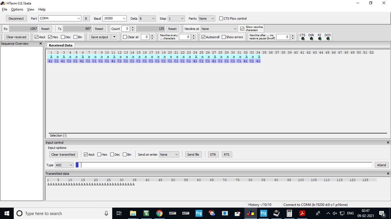

I am using STM32H753 MCU. I generated my code using STM32Cube. The UART is configured to work on interrupt, baud rate is 19200. I sent 'A' many time but most of the time I am receiving "C1" in hex instead of "41" ('A' in ASCII).
When I analyzed the data i found that I was receiving C instead of 4, B instead of 3, E instead of 6, F instead of 7. Most of the times I was receiving wrong data.

I am sending back the received character in the UART_RxISR_8BIT function.

.Attached is the Hterm screenshot of received data
